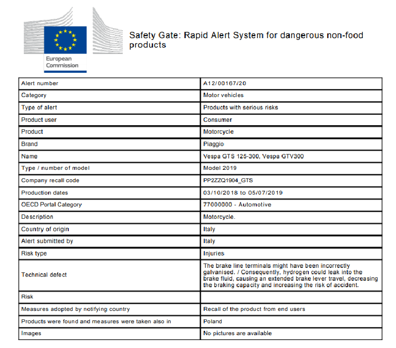

"Vespa GTS 125-300, Vespa GTV300, model 2019, production dates: 03/10/2018 to 05/07/2019. The brake line terminals might have been incorrectly galvanised. Consequently, hydrogen could leak into the brake fluid, causing an extended brake lever travel, decreasing the braking capacity and increasing the risk of accident."
