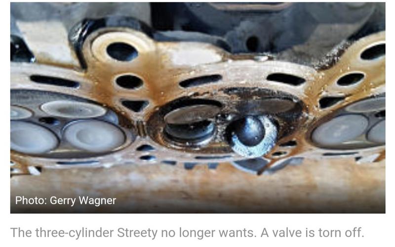

A falha de motor daquela unidade da Triumph (uma Street Triple RS que a publicação Alemã usava) e que impossibilitou a continuação do Endurance Test por problema grave de motor ocorrido logo aos 19.600kms, foi algo levado muito a sério pela marca Britânica.
E é aqui que assenta o tópico!

"(...)Under the supervision of MOTORRAD, the drive at the importer was dismantled by a delegation specially arrived from England.
The reason for the blockade was quickly found: The right inlet valve of the middle cylinder was demolished, the valve plate raged in the combustion chamber and destroyed it in addition to the associated piston sustainable.
Since the piston is not running in liners, but directly in the aluminum, the entire cylinder bank was scrap. Currently, the parts are being tested at Triumph in England. In the meantime, we have received the official statement from Triumph. All components of the affected cylinder head were, as far as possible, measured and metallurgical examined.
There were no abnormalities that could explain the damage. As a result, the engineers purchased a total of four engines from different production batches. One of which was produced shortly before the accident engine, one shortly thereafter. All four units were examined metallurgically and subjected to extra test bench endurance tests.
Abnormalities or damage: none. Ultimately, it can not be said why the valve has broken off. Triumph points out, however, that the complaint rate for valve train worldwide is less than 0.02 percent. So it is probably an isolated case.
The endurance test of a Street Triple RS should be restarted soon with a new motorcycle.(....)"

A nova unidade colocada à prova pela publicação Alemã já rola há uns meses e alcançou os 21.000Kms.
Tem agora decorrido tudo sem grandes stresses.  :nice:
Li o artigo de forma parcial, mas parece-me que apenas mencionam que a ergonomia para o(a) passageiro(a) é muito má, pois a moto não tem onde se possa agarrar.
A outra menção - curiosamente - vai para algo que também tinham verificado na Moto Guzzi V85, ou seja, os piscas são um autêntico íman para a condensação, ficando como se pode ver numa das imagens.
De resto, parece-me que tudo está a correr relativamente bem e tem ainda 29.000Kms pela frente até ao final do endurance test.  :nice:
